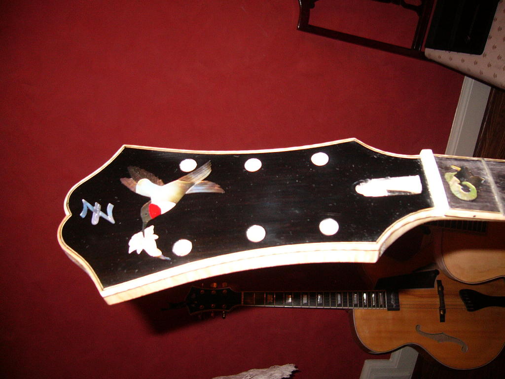

Last spring I had finished an intricate inlay on the headstock and fretboard. Headstock is bound, neck is carved and a bum 2-way truss rod snapped on me. Remarkably no tantrum, no loss of sleep! Next morning two phone calls: 1) Tony Karol how do I fix this and save all the inlay, and 2) Bob Cefalu please send figured maple for the neck - ASAP.
As it turns out, I had to resaw off the headplate (to save the inlay). Cracked a piece of pearl in the centre -- routed out the old piece - cut and dropped in a new piece in. I cut the back of the neck off in order to yank out the truss rod and CF rods, then resaw off the fretboard -- sand it down to remove the residual maple off ......Major pain in the rump!
Poor photography hides many errors

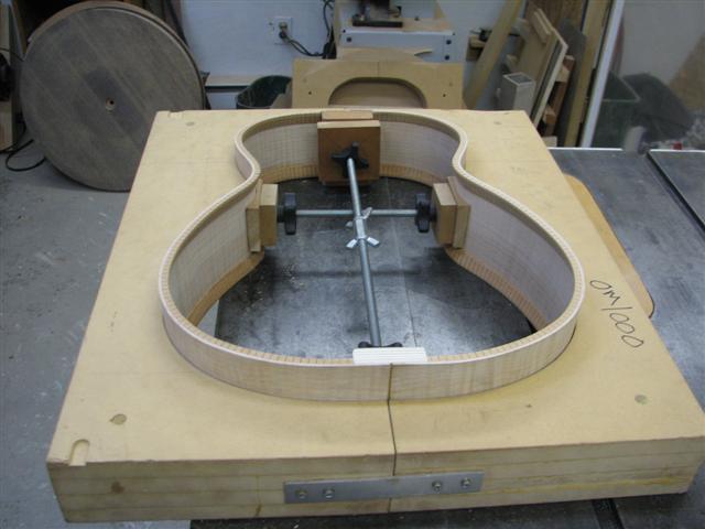

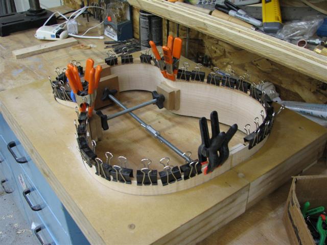

Well, thanks for the kind encouragment my friends. Yes we are all human and thankfully, most everything we do is reversable.
Well, I don't have process pictures, but I do have a before and after picture, which is really hard to see a difference. I tend not to document to many things, but I've got to learn to take more pictures so that I can help others when I can.
So, here are the before and after
Before
And after
You can sort of see that the lower bout in the second picture is smaller (it's only 1/2" less though), but you can see that the length is less (it's only 5/8" different).
See, nothing really dramatic. Just fix the sucker, that's all. sorry there aren't more process pictures. I've stated to bring the camera every time I head down to the shop.
